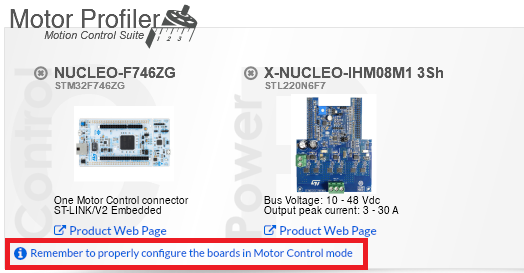

Hi @KChie.1​,
the NUCLEO-F746ZG (Nucleo-144) belongs to a different STM32 family than the one described in the user manual UM1996 (Nucleo-64).
For this reason the control board jumper setting could be different.
In the Motor Profiler select the pair "NUCLEO-F746ZG+X-NUCLEO-IHM08M1" and then follow the configurations info:
0693W00000Bd7vQQAR.pngMoreover, you can check if the supply voltage drop is also present if you supply the X-NUCLEO-IHM08M1 without connecting the control board.
Let me know you project progress.

Hi @KChie.1​,
If you feel a post has answered your question, please click "Accept as Solution"
