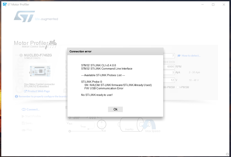

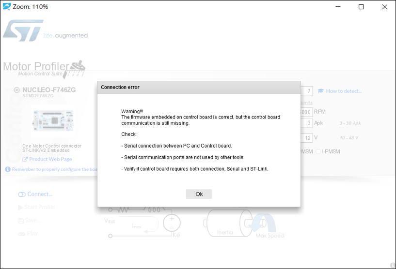

1. F746ZG can’t connect motor profiler.
if I only use a USB, there will shows an error.
if I use USB and ST-Link both, there also shows an error.
Other people also have same problem, and the problem isn’t solved.
