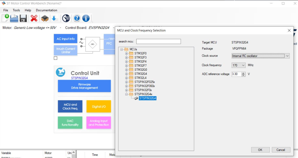

Hi @HAL-9000,
the EVSPIN32G4 evaluation boards come with a clean flash.
From your other post I noted that you do not have the external crystal mounted on the board.
Did you set the use of the internal oscillator?
You can set it clicking on the Control Unit in the MCU and Clock Frequency Selection:
Let me know if this solve your issue.
2021-06-18 2:44 AM
The picture is not the finally build board. In the final all the components are already in place, also the oscillator.
Of course, I did already try setting the internal and external oscillator in both MCSDK and in the STM32CubeMX. This does not help.
As mentioned, the same behaviour of the software generated by MCSDK I have not only on my STSPIN32G4 (built for EVSPIN32G4) but also on the NUCLEO-G431RB (built for B-G431B-ESC1).
