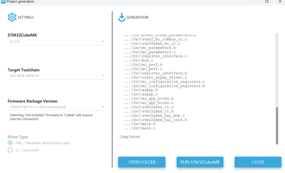

I am trying to generate code for "STM32 Nucleo packs FOC and 6-step motor control platform for three-phase, low-voltage and low-current motor" and I keep getting errors :-
Attr not supported : Dmpu as in attached image.
I am using cubeMX12, I have updated Java recently and I have uninstalled and reinstalled CubeMX as well. Still no luck. Log file attached.

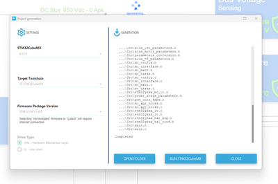

2024-07-15 1:38 PM
HI Amina,
I took your suggestion made on 7/12 to ignore the error from MC WorkBench Generation. I compiled the code under CubeIDE and ran the code with target HW. It works.
I also compared two projects, one from the MC WB example, another one from what I created under MC WB, there is no difference technically.
But I haven't tried the suggestion you had on 7/15 to remove two files under CubeMX.
