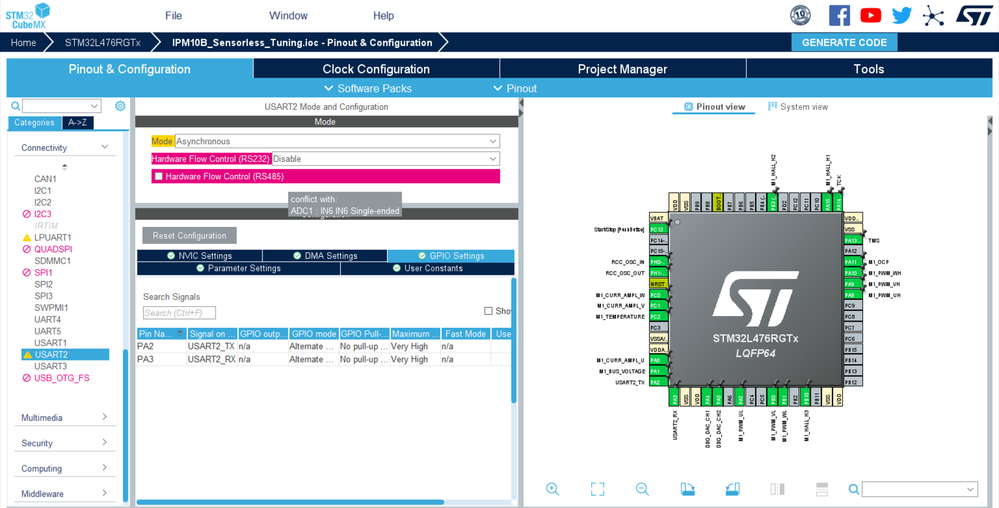

How to enable Hardware Flow Control in STM32 Cube MX , because when I am trying to enable it - conflict with ADC1:IN6 . I want to enable Hardware flow control RS485.
I have attached the screenshot of the issue being faced.
This program is generated by STM Motor Control Workbench. I haven't changed any parameter.
2024-08-30 5:28 AM
Hello @hu88
This means that it will need a Pin that is currently used by the ADC1:IN6.
