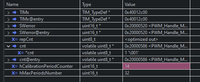

The issue is in waitForPolarizationEnd. cnt Should increase each time Index increases in R1_HFCurrentsCalibration. But it only enters pHandle->Index++; once. Can this be related to my hardware configuration? Or my ADC ISR configuration?

__weak void waitForPolarizationEnd (TIM_TypeDef *TIMx, uint16_t *SWerror, uint8_t repCnt, volatile uint8_t *cnt)
uint16_t hCalibrationPeriodCounter;
uint16_t hMaxPeriodsNumber;
hMaxPeriodsNumber = (2 * NB_CONVERSIONS) * (((uint16_t) repCnt + 1u) >> 1);
/* Wait for NB_CONVERSIONS to be executed */
LL_TIM_ClearFlag_CC1 (TIMx);
hCalibrationPeriodCounter = 0u;
while (*cnt < NB_CONVERSIONS)
if (LL_TIM_IsActiveFlag_CC1 (TIMx))
hCalibrationPeriodCounter++;
if (hCalibrationPeriodCounter >= hMaxPeriodsNumber)
if (*cnt < NB_CONVERSIONS)
*SWerror = 1u;
break;
