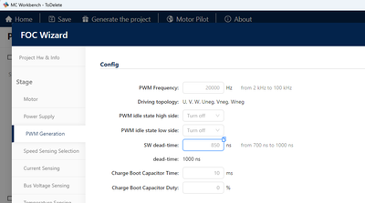

- "SW dead-time" setting in the FOC wizard

We're using variant 1 and drive both high- and lowside.
The driver stage then inserts a configurable deadtime in hardware.
I'd like to account for this inserted deadtime in the ADC current measurement so that it only starts sampling after the external deadtime has elapsed.
Do I have to use those deadtime settings for that? Or do I rather have to use the tNoise/tRise settings for that?
Deadtime is mentioned in the "Current sampling in three-shunt topology using one A/D converter" document, though I'm not sure which one that is supposed to be.
2025-01-09 12:25 AM
Hello @DMeie.2,
If "We're using variant 1 and drive both high- and lowside.", dead time is then managed by software.
