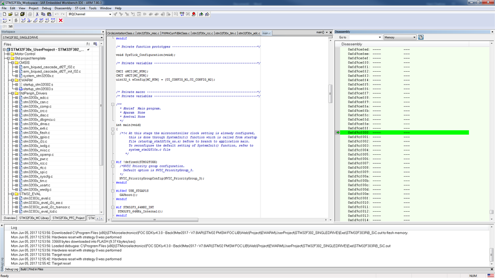

This compiled fine and uploaded but when running it always crashes and hangs. I'm not sure how it got to this location or what it is. An interrupt vector or ?:

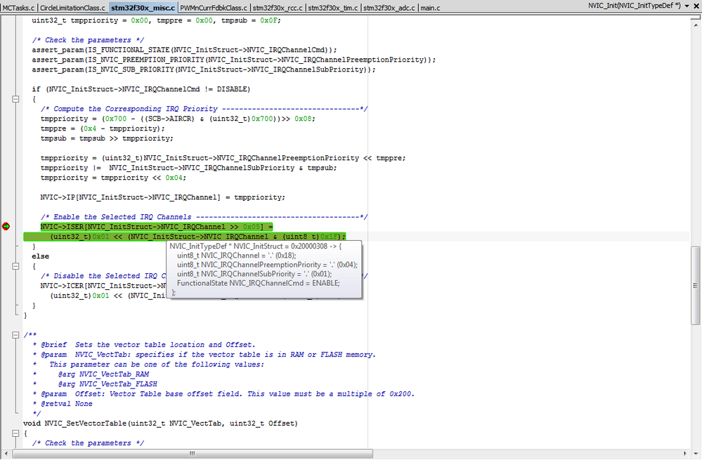

To debug, I stepped through the program until it hanged and I traced the crash point to the ''MCboot(oMCI,oMCT);'' function in main.c. So I assume something in the initialization is breaking down. Further stepping revealed that it seems to crash at the point of enabling IRQ channel 0x18 which I believe is TIM8_BRK_IRQn. If I try to step any further through the C code, it'll hang at this point. If I step through the disassembled code, it seems to get through this function but will then still hang if I let it free run after this.
