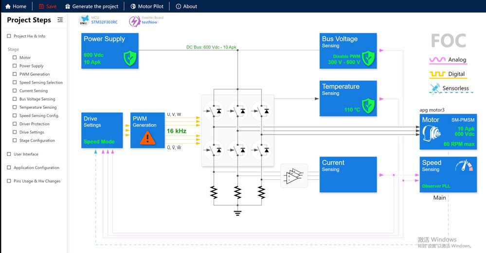

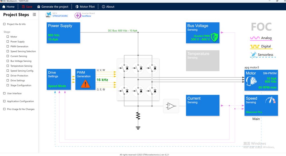

and then the picture show in MC Workbench:
only show one shunt Resistor. I don't know what's wrong with it. need to help!!!

Hello @tonyqian926 ,
Your issue comes from the pin you selected.
PA7 -> ADC2_IN4
PA6 -> ADC2_IN3
PA3 -> ADC1_IN4
The algorithm uses only 2 phases among the 3 (depending on the angle). If there is only 1 ADC connected to the 3 phases, then it does the 2 sampling sequentially. But if there is 2 ADCs, the idea is to be able to do the sampling of the two phases in the same clock cycle. To do so, one of the 3 pins must be accessible to the 2 ADCs.
In your case the suggestion will be then :
- replacing PA3 by PA5 -> ADC2_IN2, then you will have a proposal using only ADC2.
- replacing PA6 by PC3 -> ADC1_IN9, ADC2_IN9, then you will be able to use 2 ADCs with the following schema :
(U,V) sampled by ADC2_IN4, ADC1_IN9
(U,W) sampled by ADC2_IN4, ADC1_IN4
(V,W) sampled by ADC2_IN9, ADC1_IN4
Here the phase V is shared between ADC1 and ADC2.
Regards
Cedric

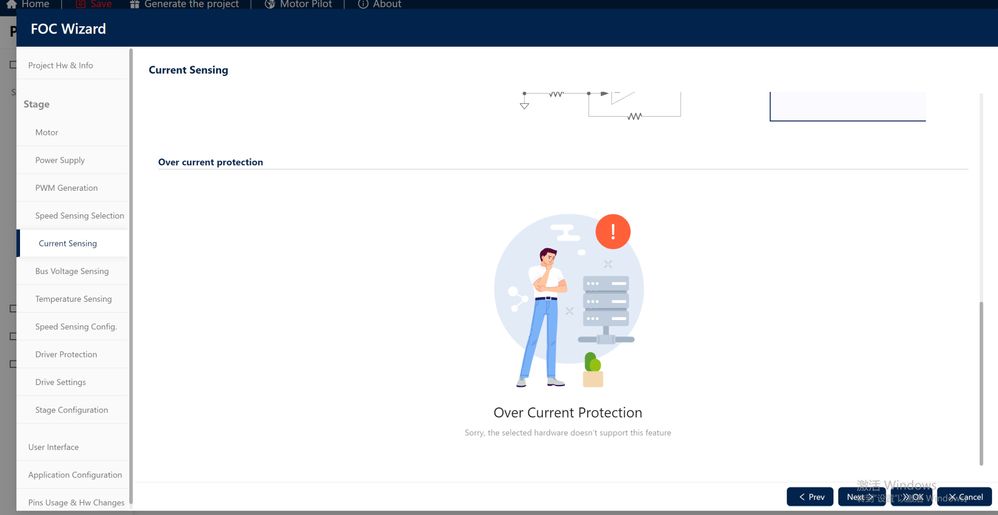

the over current protection is not show on. I don't know why?

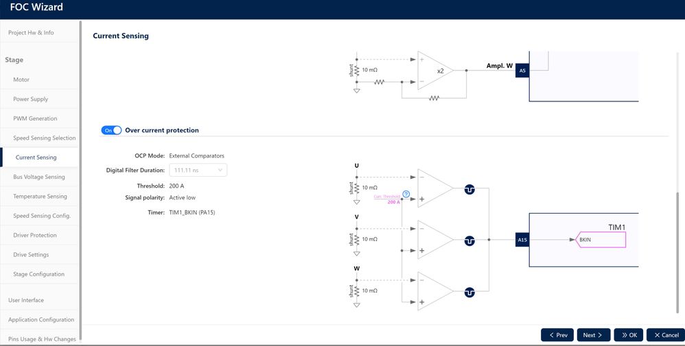

it's ok now. I changed the oc_trigger pin to PA2(TIMx_BKIN).I hadn't noticed it before.
the json code is:

and the foc wizard show:
