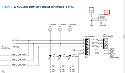

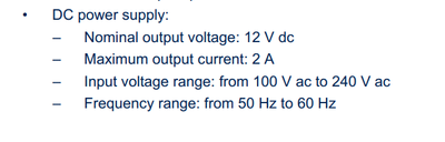

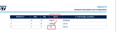

2024-03-28 2:54 AM
1, i confirmed that the out_uvw voltage is 12v
in UM2415, the OUTx voltage is same with VS,
the VS is from J4 in board x-nucleo-ihm001, the j4 is supplied by DC power.
the DC power is 12v, from DB3828
so the output_UVW is 12v。
2, i have check the other jumpers and solder bridges in UM2505 and UM2415, in confirmed that my board is the default setting.
3, if any checks for motor?
the motor used is Gimbal motor: GBM2804H-100T .
