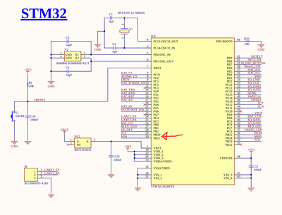

Hello - I recently took a working design and upgraded from the STM32L4 to the STM32L5. I'm having a major issue getting the i2c bus to work properly.
Here is the design, I've highlighted PB10 and PB11. Not visible in this is the 4.7 kOhm pull up resistors, but you'll have to trust me, they are there (just in a different part of the design)

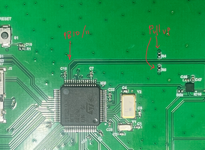

Here's a picture of the board with the pull-up resistors visible:

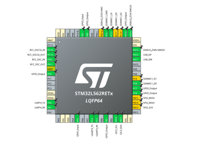

And here's my pin configuration for PB10/11

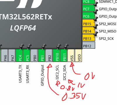

I've also attached a copy of a simple Cube IDE program you can compile and run which performs an i2c scan. However, the scan files because both SDA/SCL remain at 0.8V and 1.0V the whole time and are never allowed to pull high. These numbers don't even make sense - why 0.8V and 1.0V?!

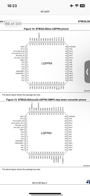

Close! Actually it’s STM32L562RET6Q. you can see the marking in your photo.
Sounds like you have an SMPS chip. Should be a Q at the end of the part number. These pads are not PB10/PB11 but rather SMPS pads.

The only thing I can think of is that my PCBA shorted some pins under the MCU or something, but I can't think of which pins would show 0.8V or 1.0V to be able to even check. None of the neighboring pins provide any clues, so I'm not even sure how to complain to my PCBA

OMG my PCBA put on the wrong chip 🤦 You are 100% correct. Thank you so much.
