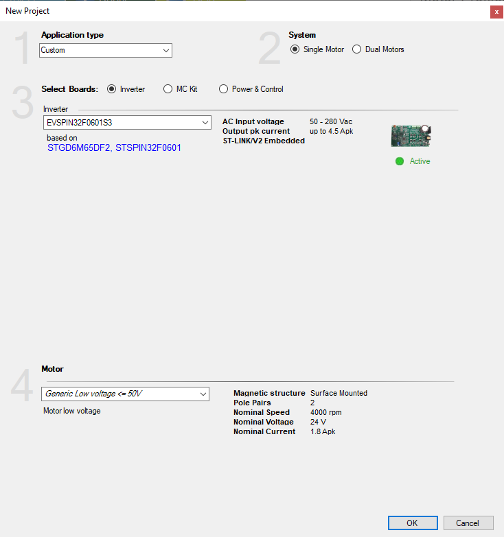

Whether you choose the EVSPIN32F06Q1S3 or the EVSPIN32F0601S3, when creating a new project select the "EVSPIN32F0601S3" among the items in the dropdown menu (see picture below).

On MotorControl Workbench 5.4.5, after selections on 1, 2, and 3 on your picture above, selecting on 4: Motor high voltage shows Poles Pairs=4, No. vol.=320, should these values be absolute on the motor to be used, what about if the motor to be used has Pole Pairs=6 instead?

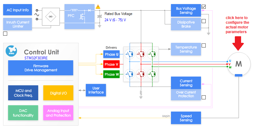

On the picture below, will the 400V DC power supply be applied on the same point referenced as AC input info, which is connector J4 on the board?
Can the Rated Bus voltage below be increased to 400V or more?

The motor selected in the point 4 is not really important, it is just an example.
In fact, you can select the “generic high voltage motor�?, then you can select in the main configuration window the actual motor parameters for your specific application.
Just click on the motor block and a window pops-up for motor parameters' configuration.
Next point: I can’t see your picture but I think you are referring on how to supply the board: J4 can be used for both AC and DC.
The rated bus voltage is max 280 VAC/ 400 VDC so do not exceed this voltage rating.
