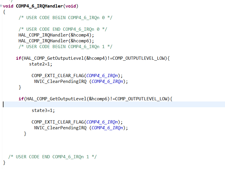

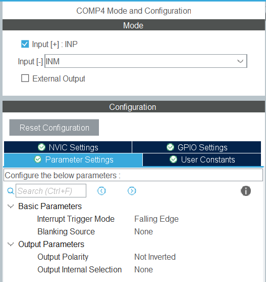

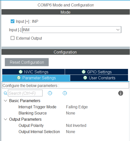

hello everyone,
ı am trying BLDC motor driver with stm32f302R8 but ı having a problem with comp4 and comp6 interrupt. when ı input COMP4_6_IRQHandler, ı try to distinguish comp4 and comp6 interrupt. but both comp4 with comp6 be activating. ı can't find solutions. please help me.
