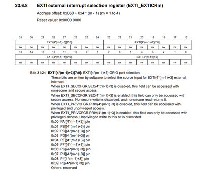

You cannot do that.
The EXTI is configured for one IO and you can't assign it to two IOs:
