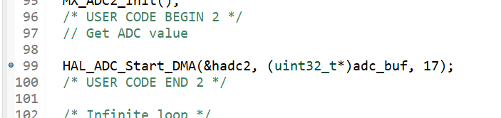

The ADC values are interleaved in the buffer. So multiply the buffer size by the number of channels. The last parameter in HAL_ADC_Start_DMA is the size in Bytes. So 17 seems odd. Use sizeof(adc_buf) or calculate by *sizeof(uint32_t) etc..
If unsure: heavily oversize the allocated buffer, fill it with 0 and validate that only the expected number of bytes/values is written by debugging/dumping the buffer.

HAL_ADC_Start_DMA(&hadc2, (uint32_t*)adc_buf, sizeofbuf);
Here I tried sizeofbuf as 3.But I cannot read the value .
Can you help me to set the exact value for sizeofbuf.

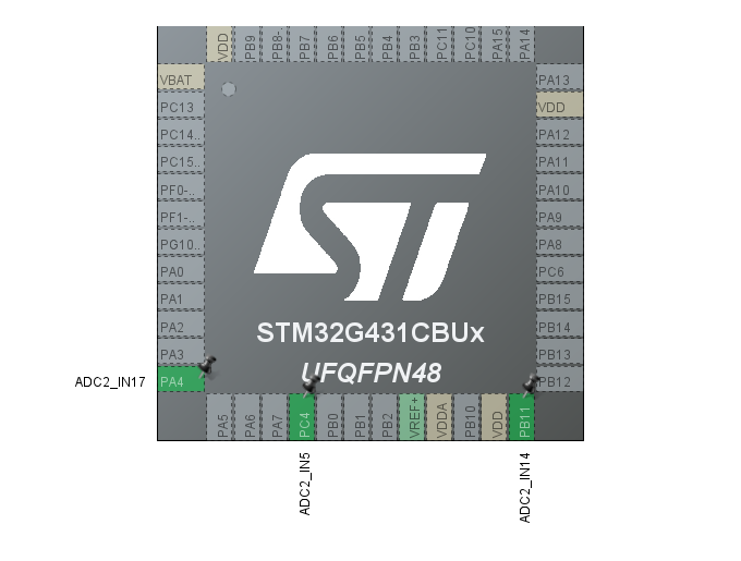

PA4-ADC2_IN17
PC4-ADC2_IN5
PB11-ADC2_IN14
these are pins used.
What sizeofbuf should i choose in this case?

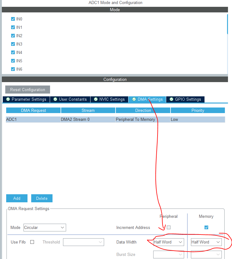

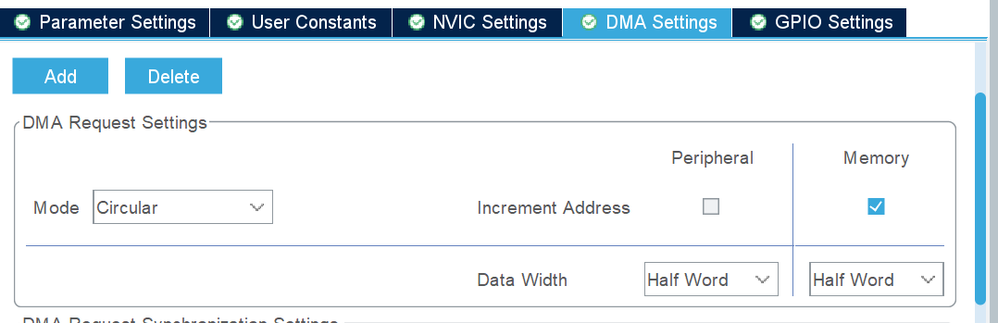

2022-01-28 4:23 AM
could you post an image of your cubeMX setup for the ADCs?
you should be able to calculate sizeofbuf with that info
match your receiving buffer unit definition (uint8_t/uint16_t/uint32_t) to the one setup n your DMA
word=32bits
halfword=16bits
byte=8bits
2022-01-28 4:31 AM
Half Word = 16 bits
so what would be my buffer size for following Pins?
PA4-ADC2_IN17
PC4-ADC2_IN5
PB11-ADC2_IN14

2022-01-28 6:27 AM
simply how many samples you need in buffer for one pin X num pins
for you for example 100 x 3 = 300
uint16_t adc_buf[300];
HAL_ADC_Start_DMA(&hadc2, (uint32_t*)adc_buf,300);but your images is chaos DMA show ADC1 instead ADC2 and checked inputs isnt as you write
