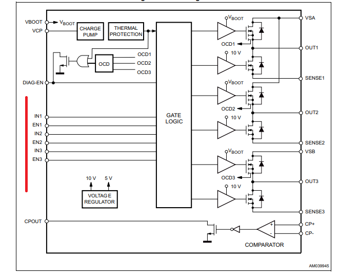

2020-05-19 11:56 AM
Thanks ..@ Claire OKU (ST Employee)
1) Will this board able to generate PWMs for Control operation of MOSFET for BLDC ?
2) How hall sensors are connected to this STM32 MCU?
