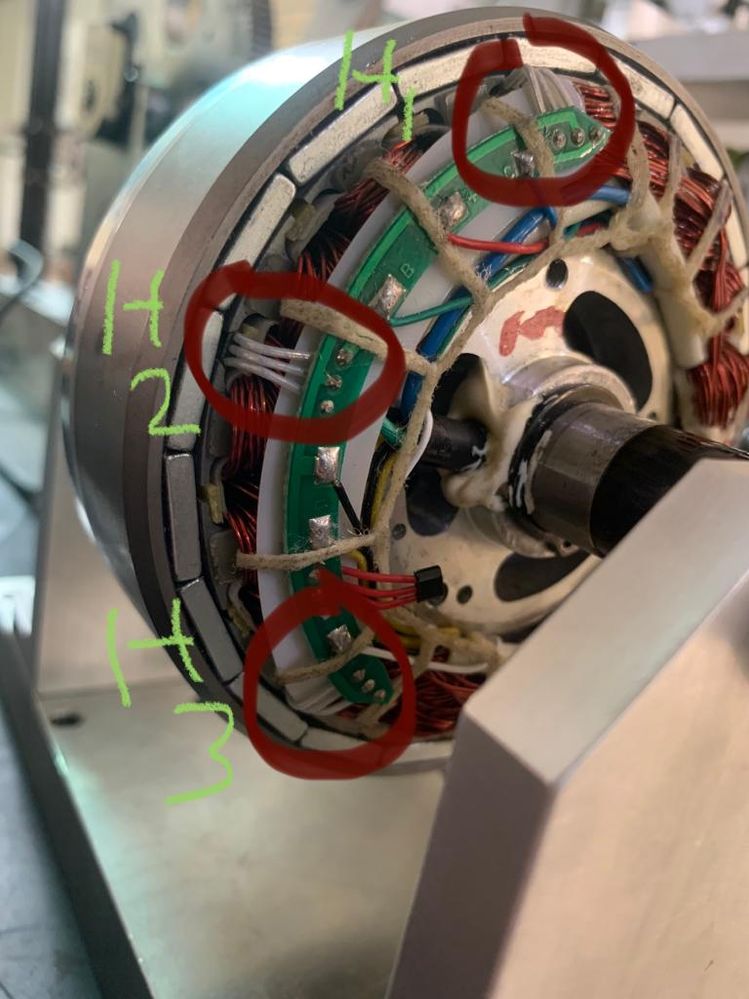

I want to develop my application using the profiles I have with me at the moment. Can you please help me find the phase shift between my hall sensors (placement electrical angle)?
Please find the image of the hall sensor placement in my motor below:

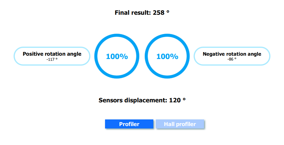

Hello @Zied b. ,
The method you suggested does not work and it fails.
Neverthless, I set a lower RPM (500RPM) and lower current (1A) and profiled it, after which, I'm able to do a Hall Sensor profiling. Can you please tell me what might be my mechanical displacement and phase difference values for the Hall Sensors in my motor, given the picture below? (when it says displacement, do they mean mechanical or electrical?)

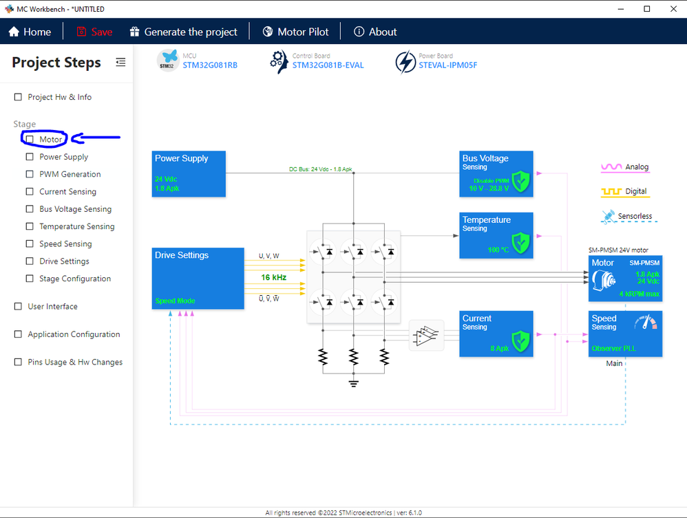

Hello @Community member ,

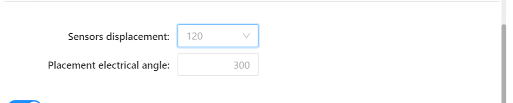

You can save the provide results from the profiler and import them on the Workbench, after that you can go on the Work bench, import your motor, go to motor section.
If you go down in the settings, you will find the fields to fill in with the results of you Hall profiling. you need to set "final result" on placement electrical angle field.
Normally, all fields are pre-filled if you import the data recorded with the profiler.

2023-01-12 4:37 AM
To start you can save the motor profiler result of MCSDK 6.1, after that import this motor on the motor Work bench and generate a new project with your saved motor.
Then you can load and flash your projet with Stm32 Cube IDE or IAR if you have it and finally use the Motor Pilot to connect to the board and control your engine .
with these steps you can see if you have a good control of your motor.
