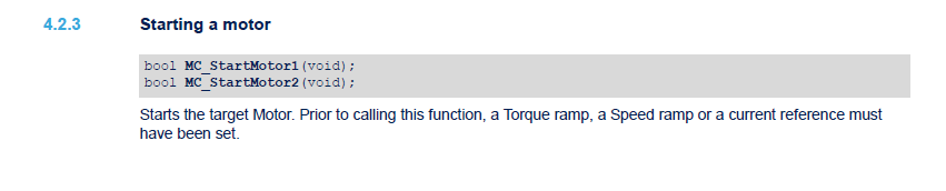

2023-01-03 11:15 PM
I found the following information in the MC Docs.My question is, if I use Hall Sensors as speed sensing, which of the above (torque ramp, speed ramp or current ref) do I set in order to start motor successfully?
2023-01-04 1:31 AM

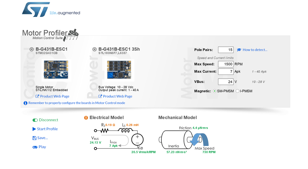

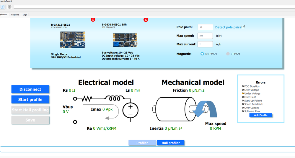

Hey @cedric H ,
I have profiled previously mentioned motor using both MC prof 6.0 and 6.1.
6.1 seems to have voltage issues since there is no max voltage parameter that we can input. I either get undervoltage or overvoltage faults. Let me share the pictures:
MC profiler 6.0:
MC profiler 6.1:
6.1 has voltage calculation issues. The profiling fails every time. Please note that I'm not even giving extra RPM (730RPM) in 6.1, while I have actually provided 1500RPM in 6.0 and it still profiled fine for 730RPM.
Also, I'm not able to profile Hall Sensors.
I have disassembled my motor so I can see the order of Hall Sensors placed in the Motor. I might be going wrong in the "Placement Electrical Angle". I've provided it has 60 degree right now.
