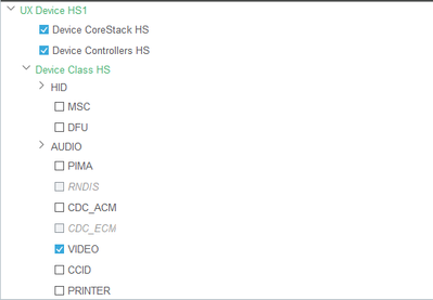

I’m working with the STM32N6570-DK board and trying to implement a USB Video Class (UVC) device.
From my exploration in STM32CubeMX, I couldn’t find any native option to enable or generate a UVC class . Based on this, my understanding is:

>Is UVC officially supported on STM32N6570-DK?
>Is there any roadmap to include UVC support in STM32CubeMX?
Indeed, you can select VIDEO class using STM32CubeMX as you can see in the caption
>Are there any reference implementations (for STM32N6 or similar series) available?
You can base yourself from this cube example
>What is the recommended approach:
You can start from a pure STM32CubeMX project and implement the necessary functions from the example, then customize the project. Alternatively, you can start directly from the STM32Cube example and modify it as required.
