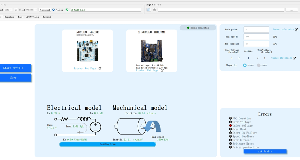

Below is the profiler's result. Ke=9.59 Vrms/kRPM.

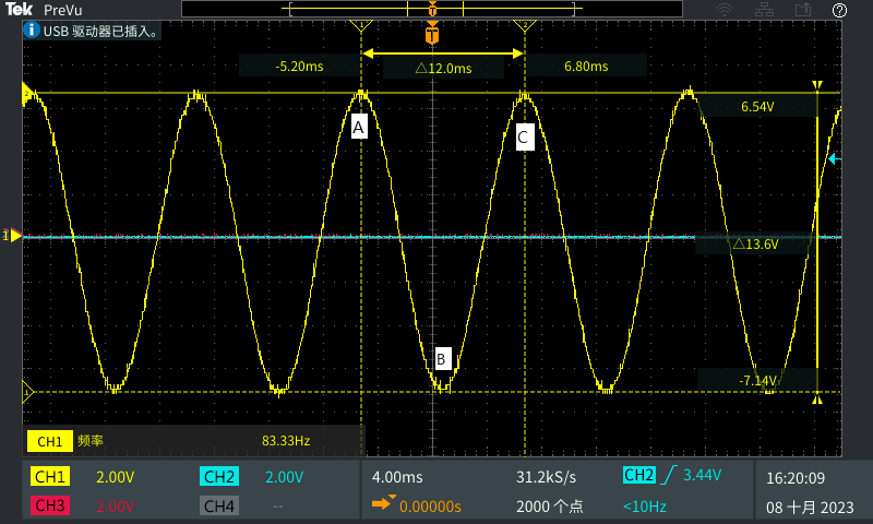

Below is my owm test.
Vpp=13.6v,pole pairs=5,fbemf=83.33Hz. Ke=(13.6*5*1000)/(2√2*83.33*60)=4.8085 Vrms/kRPM.
I wonder if I chose the wrong frequency?Is it between point A and point B or pointA and pointC?Thanks.

Hello @gtop.1,
The frequency you chose is correct. I would be more in favor of definition issue regarding the pole pairs number to explain your factor 2 difference between the profiler output and your computation.

Could you describe accurately how did you generate the oscilloscope dump ?

how did you spin your motor to generate your waveform, did you plug it to any electronic other than the scope ?

Then I use an external motor to turn my test unit to 403 rpm to measure the Vp-p of 4.02V and a frequency of 66.7Hz.

At 403rpm, a 5 pole pairs motor should have a Bemf frequency of ~33.6Hz, not 66.7Hz (403/60*5 = 33.6).
Are you sure that you have the correct pole pair number ?
