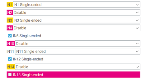

I have two active ADCs with many channels reading, some in regular converison, some injected, etc.
The code is autogenerated from MC Workbench, but I added a channel 11 for an external potentiometer.
I don't really know in the autogenerated files where the other ADC channels are read, and in addition to reading those channels, I should also read channel 11.
I ask you if this code is sufficient (in the main.c) to read also from ADC1 and channel 11:
there is the error: ADC_HandleTypeDef has no member named rank
Maybe I should add these lines of code where the other channels are also read? ..to avoid two HAL_ADC_ConvCpltCallbacks in the project.
I kindly ask you how to solve (I think bases a simple line of code that unfortunately I do not know)
Thank you.

Hello @luke514,
If you are using B-G431B-ESC1 board, why not taking the advantage of enabling potentiometer feature through Workbench>Stage Configuraton>Potentiomer? ADC1_IN11 input is used, and capture is done via RCM_ExecRegularConv() function call.
2024-10-23 9:45 AM
I used it when I selected a speed control.
In the case of torque control, I think it can not be used to vary the motor torque .. in fact during the debug nothing happens during its rotation. Am I wrong?
If I am wrong and there is the possibility to activate it also with the torque control .. my question remains the same because I have always read channels simultaneously, but now I would like to know how to read one of the many initialized ones.
