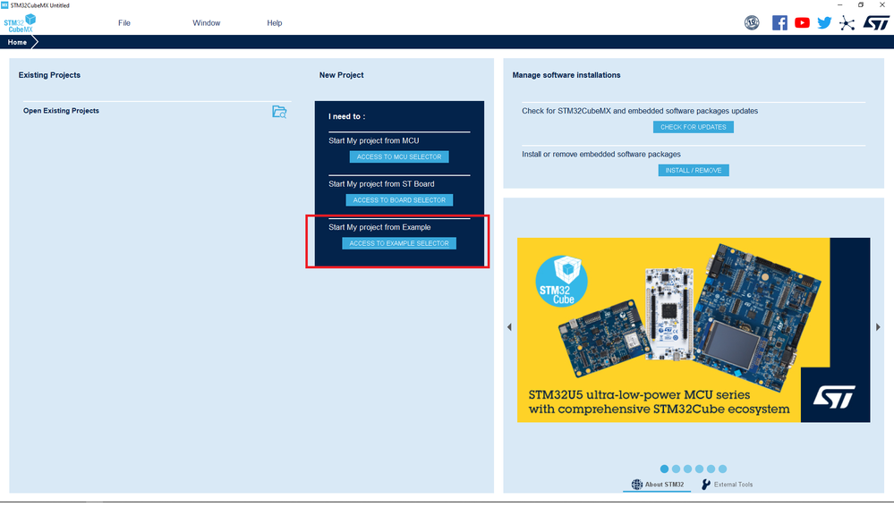

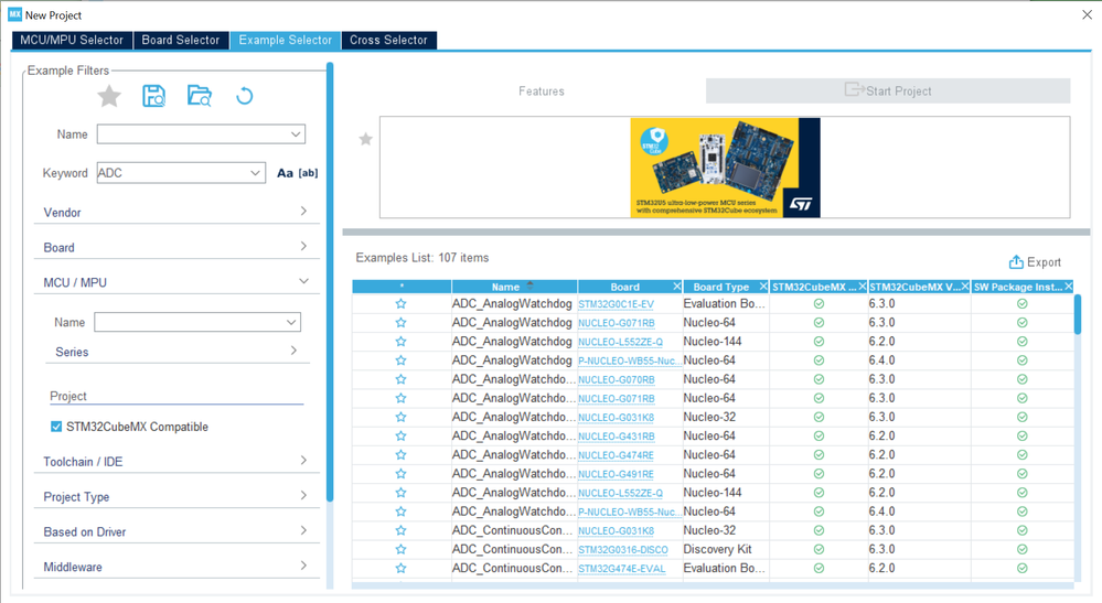

You can also find some examples under Example selector in CubeMX, some of which are Compatible with STM32CubeMX.
