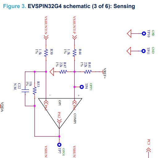

Going over the documentation for the EVSPIN32G4, this is the schematics for current sensing:

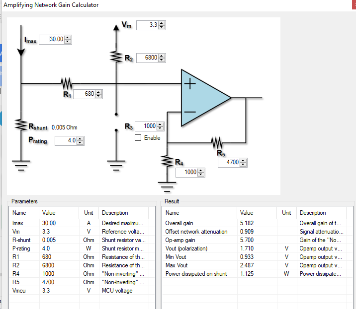

But starting a project in Motor Control Workbench for this board, seems to have different values for the same schematics:
Am I missing something? Why the discrepancy?
2022-02-01 12:48 PM
Oh, never mind, I just realized that I was looking at the setting for an external network gain, not at the embedded over current protection topology protection gain. Mystery solved!
