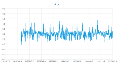

The no-load current specified in the datasheet is 210 mA, but the motor is drawing 1A, resulting in significant heating—reaching 70°C within just 3 minutes of operation. I confirmed with the motor manufacturer that this level of heating is abnormal.
I’ve tried both sensored and sensorless FOC, but the heating issue persists in both cases. I even tested a 6-step algorithm also .
motor operates correctly, the overheating problem remains.
What could be causing this excessive heating?

Hi @GMA,
I tested the motor with another controller from Maxon, and in that case, the motor only draws its specified no-load current as expected. However, when using the IHM08M1, the motor exhibits excessive current draw and overheating.
What could be causing this issue with the IHM08M1?
