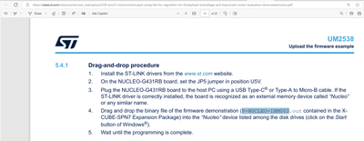

2024-06-14 11:42 PM
In Manual, its written for P-NUCLEO-IHM003 as well, it is present there but i cant find it.
