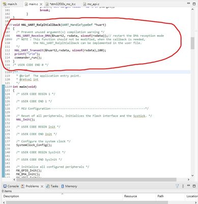

I prefer to use the function void HAL_UART_RxCpltCallback(UART_HandleTypeDef *huart) to handle the command data(maybe use if else function to identify the command data to enable MC_StartMotor1(void) or change the hFinalSpeed value in void MC_ProgramSpeedRampMotor1( int16_t hFinalSpeed, uint16_t hDurationms )) to control motor rather than Motor pilot 6.1.2.

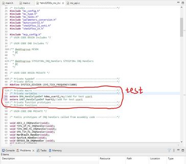

Because I still can’t understand how to use the MCP command ID to use the command in mc_api.c even though I have read ASPEP document. So I make some modification on void USART2_IRQHandler(void) in the stm32f30x_mc_it.c. I have modified USART2_IRQHandler(void) (by commenting all code generated by STM32CubeMX and adding HAL_UART_IRQHandler(&huart2); and printf("Hi!\r\n"); for testing whether HAL_UART_Receive_DMA( ) works. add extern UART_HandleTypeDef huart2; and extern DMA_HandleTypeDef hdma_usart2_rx; ) as pictures below. However, I stil get trouble on using USART2 for receiving the command data sent through the serial com port.

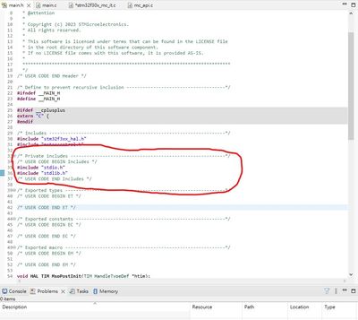

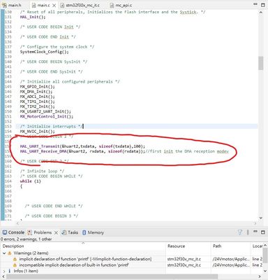

Otherwise add some codes in main.c.and include "stdio.h", "stdlib.h" in main.h..as pictures below.
It should print "hi everyone\r\n" at first after the stm32 board reboots, and then receive the string I send(for example T123456). However, it doesn’t print "hi everyone\r\n" at first and also gets stuck in USART2_IRQHandler(void) to print "Hi!\r\n" continuously.

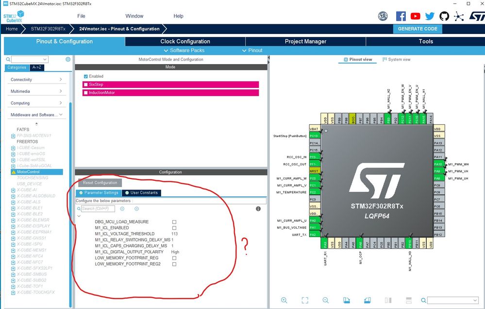

Can I disable entire ASPEP protocol function not to occupy the USART2, but still can use the function in mc_api.c likeMC_ProgramSpeedRampMotor1().But I can’t find anywhere to disable ASPEP Protocol in the STM32CubeMX6.8.1.

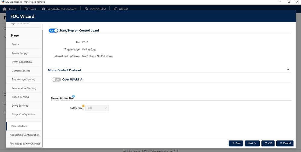

(Edited) I have also tried to disable the motor control protocol in MC workbench 6.1.2 at first. And add USART2 for what I need in STM32CubeMX6.8.1 later. The ASPEP files disappear in the generated code from CubeMX. Although I can receive or transmit data by USART2, my motor will get stop when I send the data(for example "T123456", and it can store the string into the buffer). In this situation, I must press reset button again to reboot the control board then I can use the start/stop button to start the motor to run normally. Please give me some advice about this strange problem.
