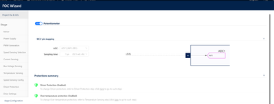

With MCSDK 6.4.0 or 6.3.2, the potentiometer feature is already proposed. You can just enable it from the "Stage configuration" window as shown below:
Once enabled, generate your project, and you will have all the leisure to read and understand the code.
The only condition to have the possibility to enable the potentiometer is that it is described in the power board (or inverter) and the signal is connected to an ADC input pin (which is the case in your pack).

Hi @Undertaker,
There is no difference between internal or external potentiometer.
If you have a potentiometer connected to your IHM07 board, then you can modify your board description to describe your potentiometer.
Here is the description of the potentiometer coming with the IHM07. MR24 means that the potentiometer_level signal is connected to the Morpho connector Right at the 24th position.
You can add your own potentiometer to another pin of the morpho connector : MRyy (yy morpho pin number)
"name": "Potentiometer",
"type": "Potentiometer",
"hwVariants": [
"help": {
"en": "Make sure that R78 is soldered and is a 0 Ohm resistor."
"signals": {
"POTENTIOMETER_LEVEL": [
"name": "MR24",
"help": {
"en": "CN10.24"
"cost": 0
"name": "MRyy",
"help": {
"en": "My own potentiometer connected to Morpho Right yy"
"cost": 0
"potVm": 3.3,
"potRmax": 100000,
"potLevelMin": 0
Doing this, the Workbench will propose you to select the MCU pin connected to your own potentiometer reachable through the connector MRyy at the condition that it reaches a MCU pin connected to an ADC_IN channel. After project generation, compilation and flash the new binary, you will be able to control your motor speed without any additional line of code. In order to take into account your board modifications, you must restart a new project with your updated board.
