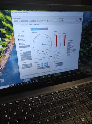

I can't increase the motor speed beyond a certain point.
For example, when using the ST Motor Pilot interface, I set the Speed Reference variable to 2500 RPM, and the Mechanical Speed reaches approximately the same value (2495 RPM). However, when I increase the Speed Reference beyond 2500 RPM, the Mechanical Speed does not increase and remains the same.

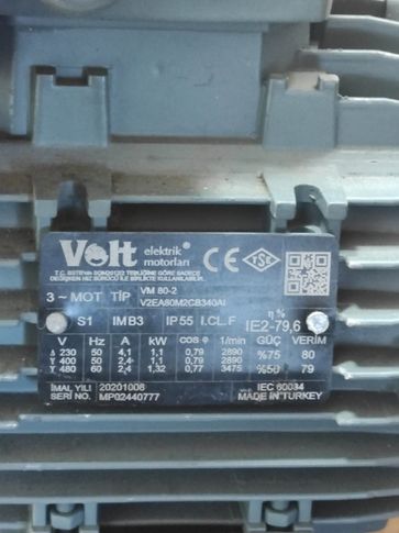

Motor parameters: in below image.

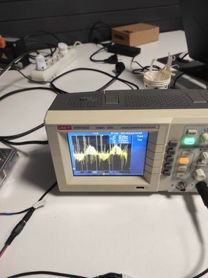

Hi @Floflo
I’ve measured the stator signal on the oscilloscope and observed a frequency of approximately 48 Hz.
This corresponds to a theoretical no-load speed of 2880 RPM for a motor with 1 pole pair.
In the ST Motor Pilot, the mechanical speed is 2494 RPM, which suggests a slip of around 13%, typical under load.
However, my speed reference is set to 3990 RPM, which would require a stator frequency of about 66.5 Hz.
Since only 48 Hz is being applied, it appears that the firmware is clamping the output frequency, preventing the motor from reaching the desired RPM.
measured frequency:
Could you please show me how to modify the firmware to increase the output stator frequency?

I am using the example provided by ST’s Motor Control Workbench in my project, as you can see in the screenshot.
I’ve also made some changes in the speed/frequency configuration settings there, but the motor’s stator frequency still did not change.

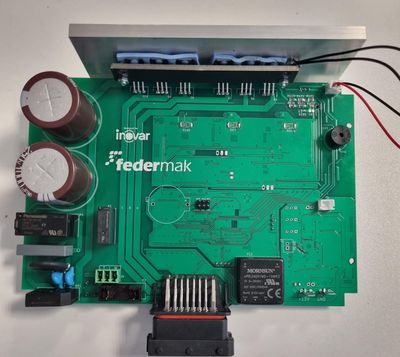

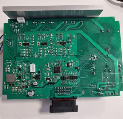

As our software manager @Omer Ab wrote before, we need to increase the motor speed to around 80 Hz. The motor used in the project can operate at high speed, there is no problem with the hardware or mechanics. We will increase the motor speed to the highest level and start mass production of the device. I am sharing the final photos of the device below. Our device needs software support. Thanks
