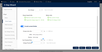

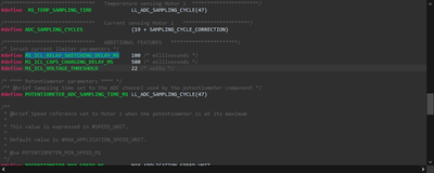

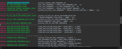

I have set ICL configurations in the MC workbench, but the generated project doesn't include "inrush_current_limiter.h" , "inrush_current_limiter.c" and any related calls, just some ICL parameters macro. What is wrong?

Unfortunately, the ICL feature is not currently supported by the 6-step algorithm. We apologize for this inconvenience. Only the FOC algorithm supports this board feature. The MCSDK 6.4.1 WB mistakenly allows you to configure it with the 6-step algorithm.
