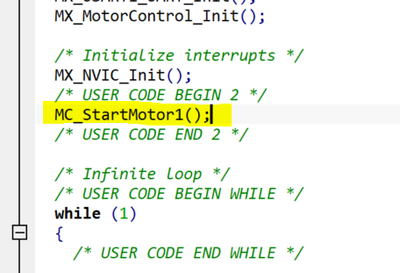

to regulate the speed via J8-7 you need to connect an external potentiometer to that pin as explained in the json file. The generation of the code is activated enabling the flag "Potentiometer" in the section "Stage configuration" of the workbench.
As far as the start/stop via J8-5 is concerned, this pin is meant to be used with an external hardware trigger switch. When J8-5 is not grounded the power supply is disconnected from the MCU and no communication is then possible with the board (please refer to schematics). So, there's no code to handle it. On the other hand, if you want the motor to spin as soon as you press the trigger switch, you only need to add the API function call MC_StartMotor1() in main.c, in the position indicated by the attached picture.

Adding MC_StartMotor1() to main.c made indeed the motor to start spin, but only for 1-2 seconds. Then it stops without any information. Do you know why?
