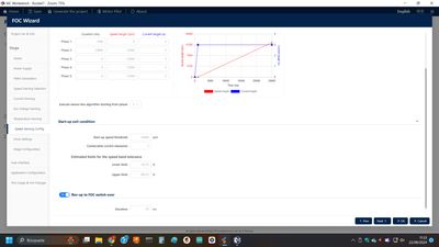

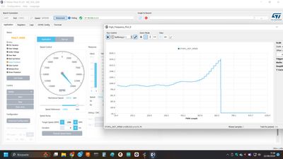

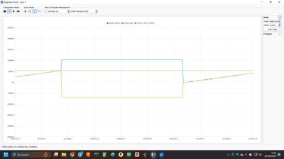

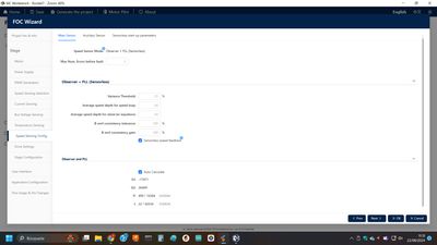

2024-08-22 3:20 AM
Hello. Thanks for your help.
I'm sending you the screenshots of the first test I performed.
The engine accelerates for a few seconds and suddenly stops.
It does not maintain a constant speed, it only accelerates and stops.
The error reported is Speed Feedback error.
In the Firmware errors section.
As a solution, the first solution indicates that the maximum value of the number of errors, the variance threshold and age speed depth vary. Could you recommend some values to try?
Tell me if you need any more parameters or plot.
Thank you so much.

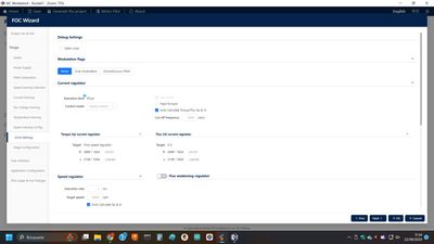

2024-08-23 4:18 AM
I have been able to solve the problem by adding more inertia mass to the engine and now the engine stays on.
The maximum revolutions I have achieved are 25KRPM but they are not enough for my application. How could I adjust to 30 or 40KRPM? (My motor supports up to 60KRPM)
I have increased the PWM frequency to 30KHz but the speed has not increased. Should I go up to a higher frequency?
I have read that activating the Flux weakening regulator option can increase the engine RPM.
Should I do it?
Thank you.
