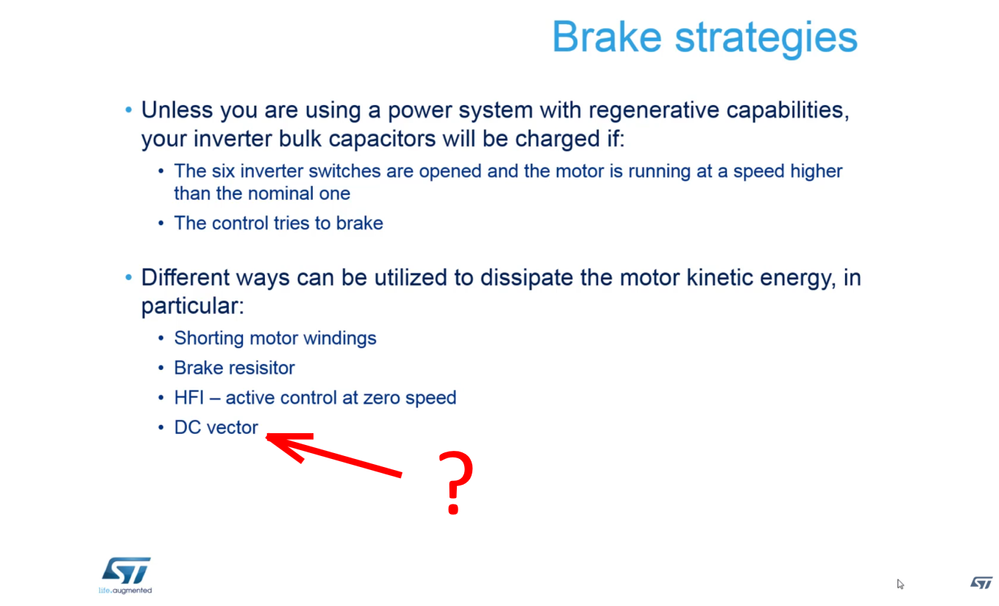

2021-10-06 8:05 AM
Thanks for your answer. Can you also tell me what "DC vector" means from the attached slide?
