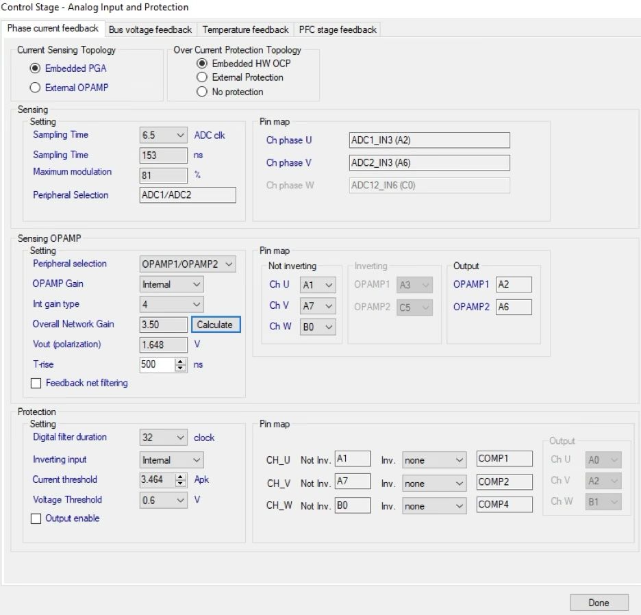

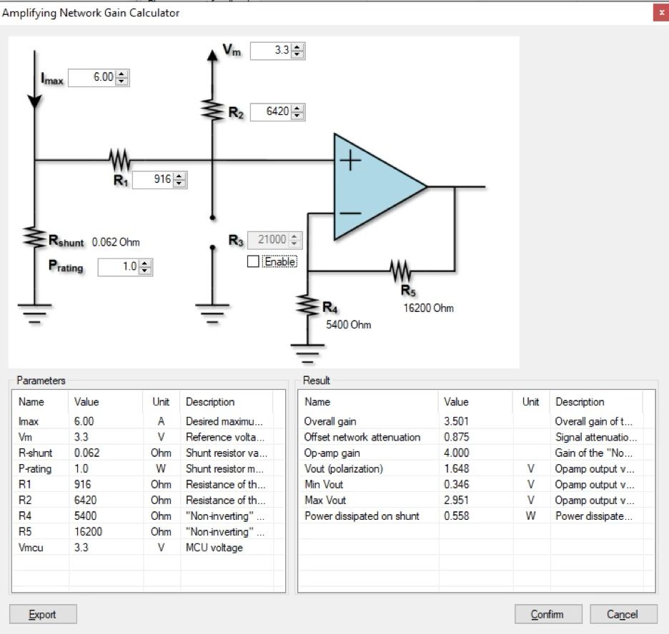

I have a custom motor control board and have so far been using MCW 5.Y.4
This is my Amplifying Network using internal Op-amp gain of 4x and I just have external resistors R1, and R2. The resistors R4 and R5 are internal as you well know:

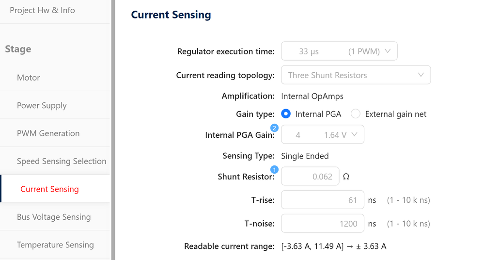

1.) Channel W is connected to OPAMP2, but I believe that doesn't change anything since my board has same resistor network for all three op amps and I understand that channel V will be inferred from the two other channels
2.) Internal PGA Gain of 4 (600mV) is not an option, even though this MCU has that as an option and previous firmware allowed that as you can see form the screenshot. Is this just a bug in the system, and can I simply change it manually in the code? I designed our board based on a gain of 4 so I really need that to be the case.
3.) There are no inputs for the external network for gain offset, as I had before as you can see in one of the images above. However, since that is an analog input does that mean that it won't make a difference for the firmware as long as it is between 0 and 3.3V?

Hello @PCama.1 ,
2) "Internal PGA Gain of 4" is not available in the original EVLSPIN32G4-ACT board because it will not respect min/max VOUT or polarization offset limits for example.
Modifying EVLSPIN32G4-ACT.json file with your parameters, Internal PGA Gain of 4 is available on MC Workbench.

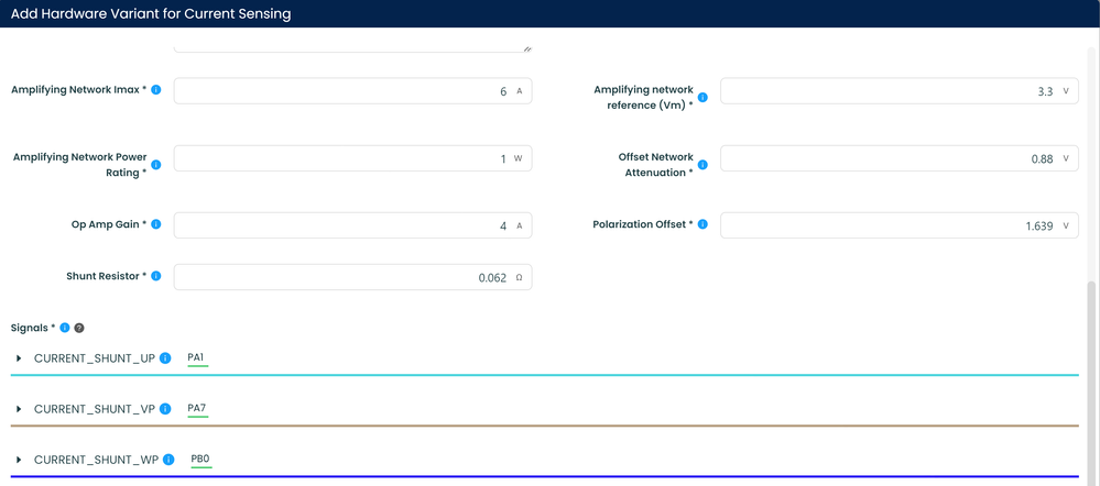

Hello @PCama.1,
Custom Inverter board .json files could be located in "~/.st_workbench\hardware\board\inverter".
You can also use "STMC Board Designer" tool: clone the EVLSPIN32G4-ACT board, edit and modify parameters and save it.

2. I set up current sensing internal OpAmp gain and our board shunt resistor, offset network attenuation and polarization offset, same as we had before in my original post:

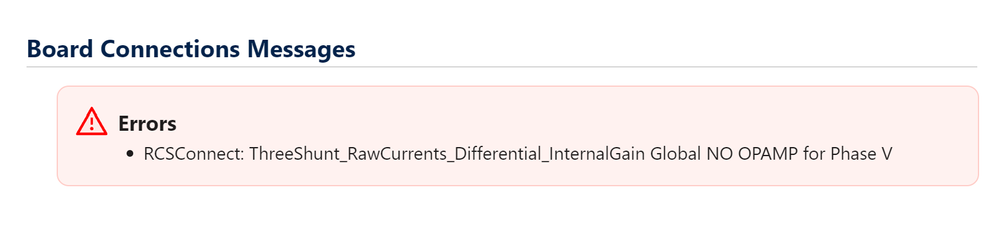

3. Then I created the project with the updated board, but I am encountering issues as you can see in the pictures below. There is a warning for current sensing, a weird current readable range and another warning at main screen.
2025-01-18 11:23 AM
Sorry for the multiple posts, but after I cloned the board and changed the .json file directly, as you suggested, everything seems to be working fine now.
