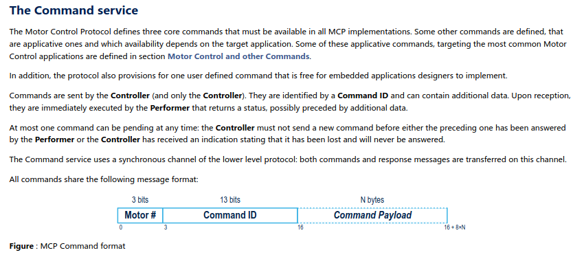

Hi, I am using L476 controller with MCSDK 6.3.0 to control the BLDC motor, able to control the motor with Motor pilot application. However, i need to control the motor using serial communication IDEs like Realterm or Putty.
I referred the document "Motor Control Protocol Suite" but didnt succeed in understanding and implementing the same. Please share some examples of the commands.
I want to use command service only not the ASPEP. Looking forward for the support as soon as possible.

Hi,,
Thanks for the info, but i think you are suggesting me to customize and rewrite the motor control protocol.
Instead,I want to know the command service already defined in the default program generated using motor control workbench. Please explain with an example like what to send command for "Motor #" , "Command ID" , "Command Payload" as its not clearly defined in the document.
Like for example:
1.TO GET_MCP_VERSION:
Motor# : 000
Command ID: 0x0000
Combined command will be : 0x00 0x00 0x00 0x00
Is that so? Please suggest. Thanks in advance.

I am using MCSDK 6.3, still am unable to decode. I want to change the motor ID, so that i will be able to address the particular motor. 4 motors are connected on single bus.
