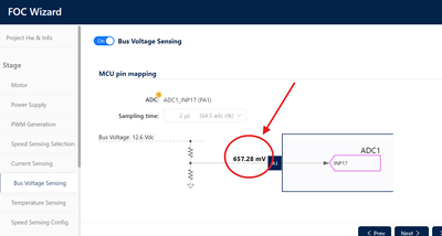

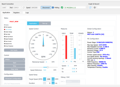

1 . This is my setup(ATTACHED BELOW) and you can see the SB80 ,84 got removed . Is there anything I'm missing out...? Haven't changed anything else .
2 . AGAIN THE VBUS ERROR POPS UP :
WITH 12 V SUPPLY ON J1 :
CASE 1 :
# WITHOUT NUCLEO CONNECTED :
0.6 V IS MEASURED ACROSS C7_30(PA1 IN NUCLEO) IN IHM07 .
CASE 2 :
# WITH NUCLEO CONNECTED :
1.56 V IS MEASURED ACROSS C7_30(PA1 IN NUCLEO) IN IHM07 .
IS THAT CREATING THE PROBLEM..?

Hello @hyden_a_mist,
You are right, C7_30 at 0.6V should remain with or without NUCLEO board connected.
Second point, the red LED is not supposed to be switched on as PB14 is not used on our motor control use case.
Could you check PB14 and PA1 level on NUCLEO board without Power board connected?
Could you try with another NUCLEO board?
