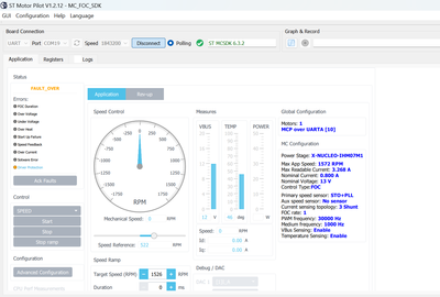

2025-03-25 4:09 AM
Thanks for providing the hex file @GMA .
Still It is not working .
But the vbus over voltage and temperature sensor error got resolved...!
1 . DID THE CODE WORK AT YOUR END..? AND HAVE YOU MADE THE MOTOR RUN...?

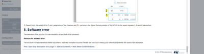

2 . I FLASHED MY CODE AND YOUR CODE , ITS SHOWING UP FAULT OVER .
( IN DRIVER PROTECTION ITS SHOWING UP SOFTWARE ERROR ).

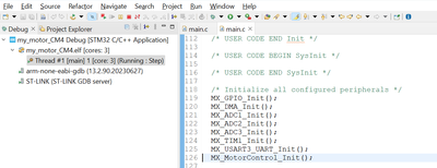

3. WHEN I TRIED DEBUGGING USING IDE , IT GOT STRUCK(INFINITE LOOP) IN MX_MotorControl_Init() FUNCTION.
2025-03-25 4:37 AM - edited 2025-03-25 4:38 AM
THIS IS WHERE IT GOT STRUCK EXACTLY INSIDE MX_MotorControl_Init() Fn

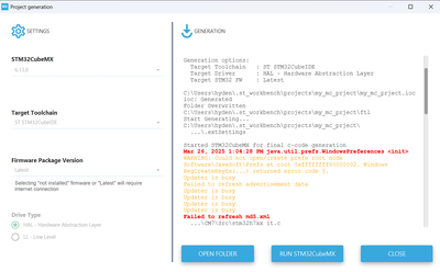

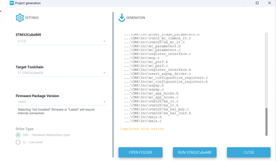

But i have faced some issues while generating the code .
1. COMPLETED WITH ERRORS :
2. WARNING :
These warning matters...? if so what should i do to resolve this issue .
