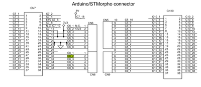

2025-03-28 11:59 PM
C7_30(PA1) is driven higher voltage than 0.6 by C8_2 .
After removing the connection between C8_2 and C7_30 , the vbus sensing works fine and 0.6v is given to PA1 and motor pilot reads it as 12v.
CAN YOU @GMA VERIFY AT YOUR END AS WELL .

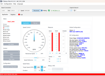

2025-03-11 4:21 AM
This is the error that pops up when i try to start the motor using motor pilot
2025-03-11 5:54 AM

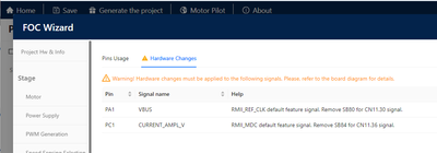

Hello @hyden_a_mist,
At generation step, you have the following message, SB80 and SB84 have to be removed:
On Pilot GUI, VBUS exceeds 20V and your motor is a 12V. Temperature is also wrong.
As soon an error is reported, it will prevent PWM generation.
2025-03-11 11:11 PM
Actually i probed the vbus its just 1.5v(PA1) , but in the pilot its measuring as 29v .....And i have removed the sb80 and sb84 before hand..

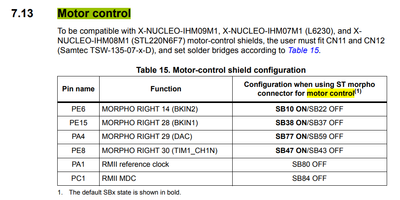

2025-03-12 12:10 AM
seems like pe15 pa4 pe8 all are reversed , eventhough it's mentioned as SB's mentioned in bold are default...but in the board both conditions are reversed ...can you verify that..?
2025-03-13 5:54 AM
You are right for the documentation, thanks for the reporting. By default, in current use case, BKIN1 is used and connected to PA6, and BKIN2/DAC/TIM1_CHIN signals are not used.
