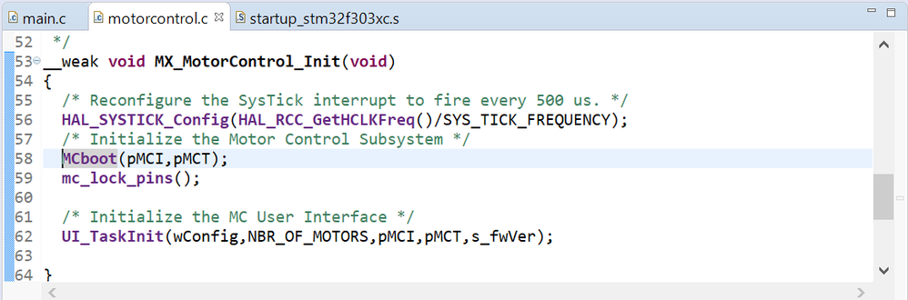

Later, I enter the debugger mode and when I step into the code MCboot(pMCI, pMCT) inside MX_MotorControl_Init() in motorcontrol.c, it stucks on this line. I wonder what would be the problem.

HI for anyone encounter the same problem. I just solved this issue. Before assigning pin in st motor control workbench, please check if the pin really exsist on the chip. If you assign a pin which is doesn't exist, error occurs.
