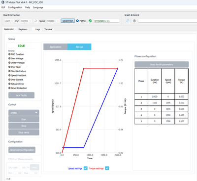

Hi @GMA ,
Yes I used motor profiler tool for our Motor, My motor has 8 poles and a peak current rating of 1.6A. I attempted to profile it with a max peak current. Setting the current limit to the motor's peak of 1.6A resulted in intermittent speed feedback, and the profiling process failed to complete successfully.
To resolve this, I reduced the current limit to 1.2A, 1.1A, 1A, and 0.9A, which allowed the profiling to be successfully completed. I've attached one of the successful profiling data logs.
Could you please help me understand why I had to reduce the current below the motor's peak rating for the profiling to work correctly? Is this expected behavior, or could it indicate a potential issue with my setup or the motor itself? Might this peak current reduction be causing the above-mentioned stalling-at-start issue?
