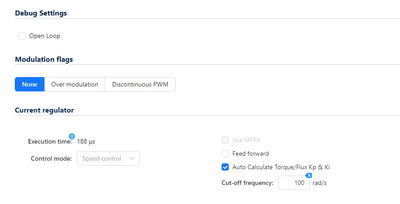

Hello, I am using an inverter board. After I modified the value of the charging capacitor, I will no longer report hardware faults. Now, overcurrent will continue to be reported regardless of the value of M1-CARGE-BOOT_CAP_SUT_CYCLES. Even if I set the value of Cut off frequency to the minimum (100) rad/s. Then I tried to turn off the overcurrent protection, but unfortunately, all of them were destroyed. My six MOSFETs were directly damaged, and I am preparing to weld a new board for testing. Do you have any good ideas

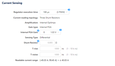

This is my configuration for current detection
