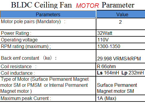

Below are parameters which I have:

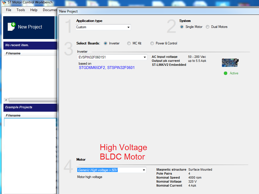

I have download below softwares :
And seen below Eval-Board .

Meanwhile, I am trying to learn MC-SDK for EVSPIN32F0601S1eval according to motor specifications given at Msg#1.

1)
When I have EVSPIN32F0601S1eval board with me do I need only Enter Motor Parameters as in Msg#1 in mcsdk to spin the Motor ?
2)
Do I need to change Feedback resistance(s) in Board EVSPIN32F0601S1eval board .
What kind of other changes in mcsdk ..?
Any other suggestions..

1) no idea, you should first run the motor profiler tool to get your parameters.

2021-05-10 7:15 AM
@Javier (Community Member)
EVSPIN32F0601S1 or S3 is not supported my Motor profiler Tool Yet
