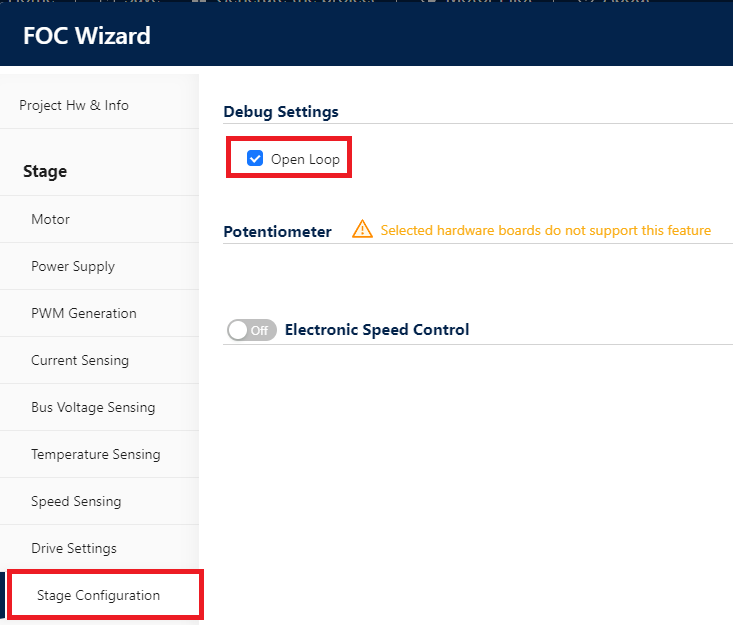

You can enable "Open loop" feature in your MC workbench project and regenerate it:

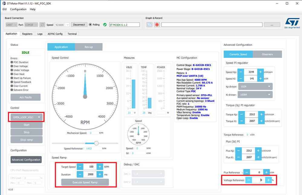

Then flash your firmware and select in MCPilot: OPEN_LOOP_VOLTAGE, set a voltage reference (few percent depending on your motor), and a speed ramp (few RPMs). Start the motor and check that the motor spins smoothly
The picture below shows an open loop voltage setting with B-G431-ESC1 board.

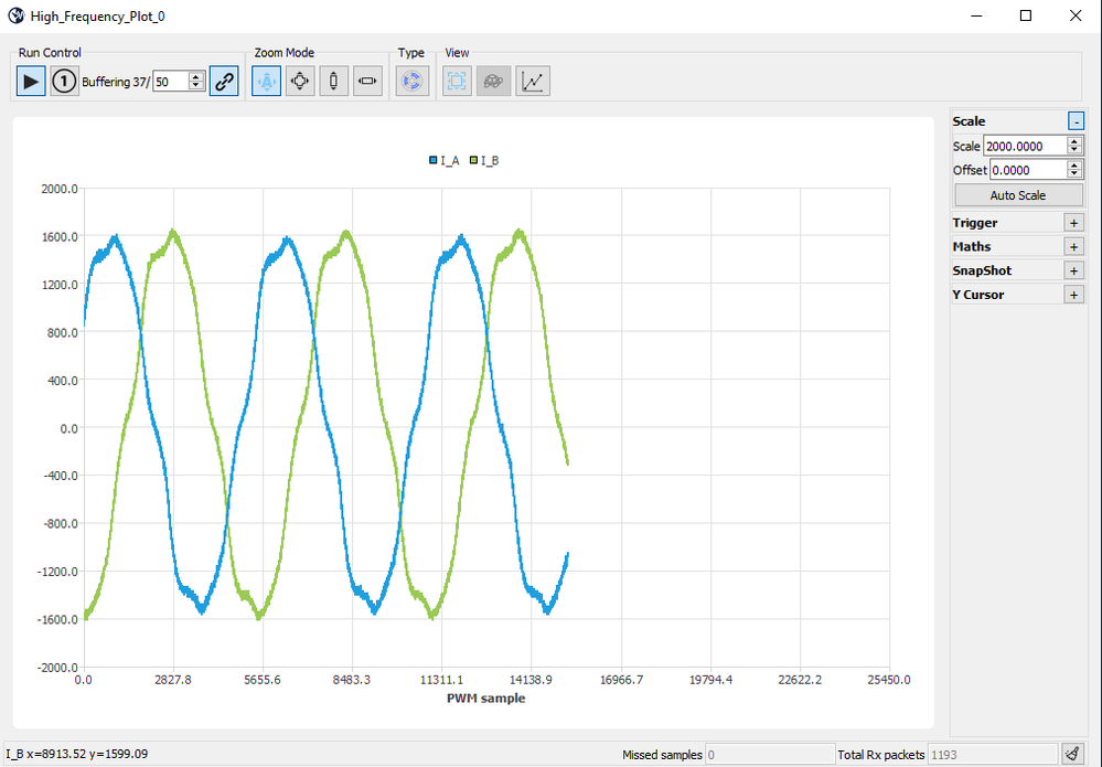

Then check the signals processed by the firmware like currents, voltage. the pictures below show the currents "read" by the ADCs.

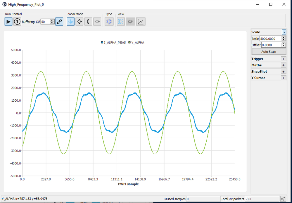

You can also compare the currents to the voltages like the picture below
This experiments will give you some hints on the current sampling.

Once I did that the open loop control allowed me to observe the drive and motor at very low power. The high speed trace confirmed what I have been seeing on the cro. I had a lot of noise, and on the 0v/ground rail. So I have rearranged the circuit to remove small earth loops (now star connection) and provided more and closer caps. I have the motor now behaving as it does using the B-G431-ESC-1 pcb. So thank you for the assistance that allowed me to see this.
