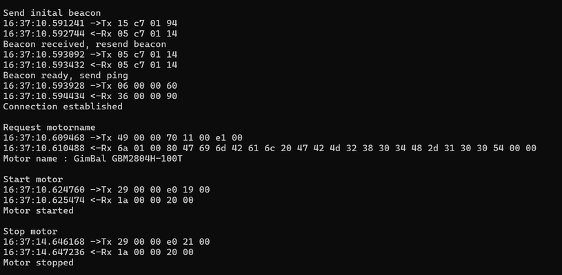

I started with your Phyton code, but the communication seems not stable. Even with the pause, sometimes the request for f.i. motorname failed.
I switched to C++, and now all communication is stable.
I used the serial lib: https://github.com/wjwwood/serial as a base.
I assume it has something to do with the serial lib in Python (I used pyserial).I'm not an expert in Python programming
A snapshot here from my C++ code (similar output as the motorpilot). Motorpilot is very handy for understanding MCP/ASPEP and debugging.
