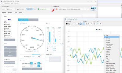

5) open Motor Pilot and build the connection
6) start the motor in speed or torque control mode. And the motor runs as expected. The three phase currents are monitored with current probe. The waves are symetrical and ok.

2025-05-26 12:55 AM - edited 2025-05-26 12:57 AM
Hello @GMA ,
the phase currents are measured with current probe and osziloscope. The MC Motor Pilot only show the RMS value but not the wave form. And I want to check the current wave form.
The point is not which signal is tracked or meausred in with tool, but why SWV introduces noise to the control. No matter what I track with the SWV tool, when it's activated, noise is introduced.
Is there any ST tool that I can use together with MC Motor Pilot for debugging purpose? I need to track some standard signals like voltage, current, as well as self-defined variables from self-defined functions.
Best regards,
STM32User

2025-05-26 2:54 AM
Hello @GMA ,
thanks for the answer. I also tried that. Since there are only register signals available, and I want to track some self-defined variables, it somehow limits the usage.
I will write the self-defined varibles to register to monitor them in High_Frequency_Plot, as a workaround.
