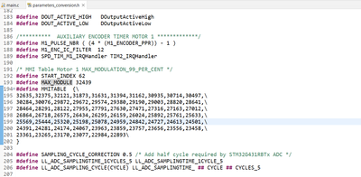

Where can I find or monitor the modulation index value in the interface?
2025-06-30 11:50 PM
/* MMI Table Motor 1 MAX_MODULATION_100_PER_CENT */
#define MAX_MODULE 28000
parameters_conversion.h file
28000 i used but it can go higher as well.
2025-07-01 1:01 AM
2025-07-01 1:39 AM
The maximum is 32767 you can try over modulation. I don't know the exact root cause I am telling based on my experience so you can decide to follow or not.
