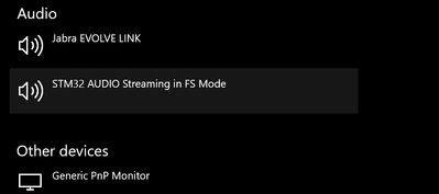

Hello @Loulou
Could you flash the code as described in read me? I have run the example, and it works without issues. I can hear through Audio streaming in FS mode using F769 disco board.
