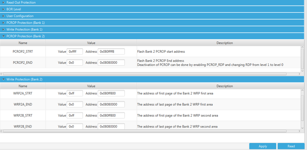

Are you sure you didn't accidentally lock the page?
2020-12-15 10:53 PM
Page don't blocked
