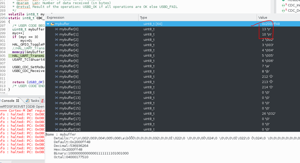

Here an example where byte with value 12 is missing, *len was 2

The chines FDTI clone used as receiver /dev/ttyUSB0 on TX of STM32 removes CR and LF
