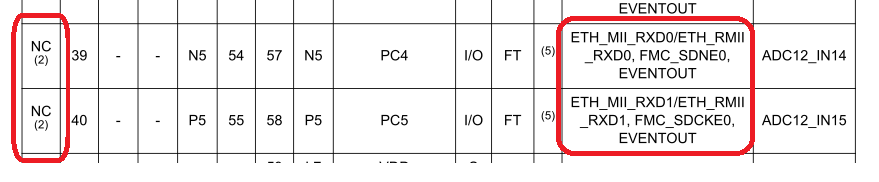

I looked in the datasheet and reference manual both. I see NC in LQFP-100 column. When this device is selected in STM product selector it shows that the Ethernet is available. Unfortunately, now we are stuck.

After check the MCU Selector: Ethernet is not supported for STM32F469 on LQFP100 package.
As mentionned in the STM32F469xx datasheet: the pins are not bonded (not-connected) for the ETH_RMII_RXD0 and ETH_RMII_RXD1 on LQFP100 package. They must be configured by software to output push-pull and forced to “0�? in the output data register to avoid extra current consumption in low power modes.
