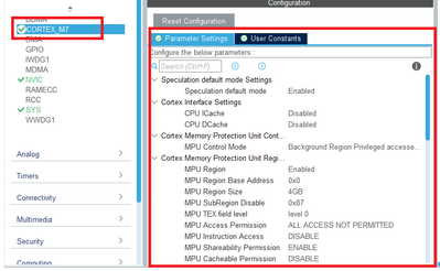

2026-02-15 7:58 AM - edited 2026-02-15 8:00 AM
Use the MPU menu in CubeMx to add the new region for SDRAM:
